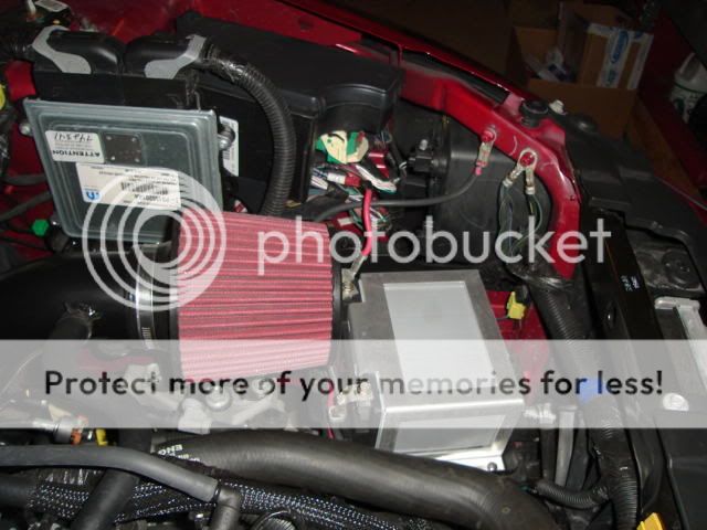

decided to shed a few easy LBS by installing a lightweight battery
it shed 17lbs off the front of the car for about $130
Parts:
Deka EXT16L battery
Braille 2317 battery mount
simply mounted the battery laying down on the OEM tray
I opted for the Deka battery vs. the Braille no weight since Deka/East Penn Mfg produces the Braille battery. So instead of paying $140 for the battery,I paid $80. Unless you want the sticker that says Braille>>>they are the exact same
I also live 2 miles from the Deka battery plant
OEM battery weight (actually thought it would weigh more)
Deka EXT16L (Braille 2317 equiv)
installed pics

Thats a good point Mitsuwa... I was going to ask about crank rating and drain on the battery in traffic.
Because of winter, power is key in -20deg. starst!! LOL

how do these work.. I have seen them.. do they work the exact same in all conditions as the factory only half as light? Sorry ROOKIE

let us know if you have any problems with start-up after playing the radio with the car off
I'll post the spec sheet tomorrow
new AGM batteries are pretty powerful regardless of the size
most guys go with the ETX14 which is smaller yet and only weighs 11.5lbs
I liked the CCA more on the EXT16 which is why I went with it
