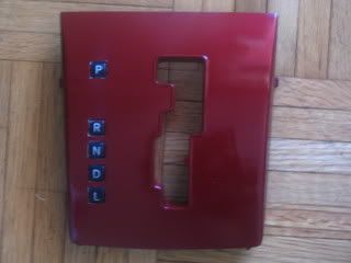

thanks, it was hard work and patience. the pc is mounted under the passenger seat. at first it was a pain to have it there because when driving it was moving too much to the point the HDD and audio cables would come loose! but i secured the pc to the floor using bungee cables. i also had to secure the HDD ide cables with zip ties. but its working great now. i now have navigation, wireless internet(dial up speed) mp3, video, & dvd. im working on phonecontrol & game emulator.

nice really nice i wish i could do it in my cali
but why u didn't painted it with a littile glitter on the red paint
maybe it well look much better

you cant see it in the pics but the little glitter is there. it would had came out better if i had more even coats. the top shows more glitter than the the face. the bottom doesnt show glitter that much and seem more dull. what can i say my 1st time painting. overall is good. i could have sanded it down and did it over.
