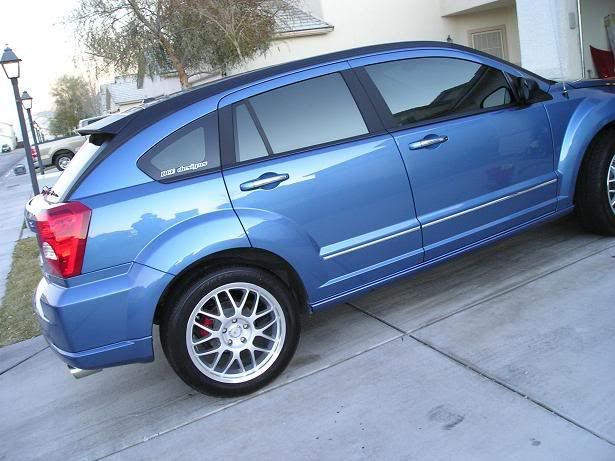

Detailed my Caliber today, got MOST of it done. hard to deticate the time i wanted to it when im also watching my 6 month old boy. started around noon, and had to call it quits when it started to get dark. i got everything done but the final wax... so ill do that in the morning and maybe get a couple more pics up.
I usually start out by doing the engine bay... for this i use a damp wrag w/ soap and water, cover all my electrical components, then do a light wrinse with the hose. Afterwards i detail it up with a rag, and a detailing brush, and some WD-40.
I then wash the wheels,calipers and wheel wells with warm water and Meguires Classic Gold car shampoo.
After cleaning the wheels i dump the wash bucket and refill with bath temp water, and again use the Meguires Classic Gold on the entire exterior of the car. (usually wash it twice) and i always use Microfiber rags or a microfiber wash mit to wash the car.
I then dry it off using The Absorber drying towel and a microfiber cloth to get up all the little spots... (btw, the grill leaks water like a mother f**** and it drives me crazy)
After its completely dry i go around the entire exterior of the car with a claybar and Mothers Showtime deap cleaner. This is an annoying process just for the fact that you cant let the Mothers Showtime dry, or you have to go over it again. So, you always have to have a dry microfiber cloth on you to dry the small areas after you use the claybar. Now, what the clay bar does, is it picks up all the deap dirt thats built up in the clear coat that washing doesnt get it... its very affective and leaves your car silky smooth.
When i was done with the clay bar i took out my Craftsman power buffer and went over the entire car with some 3M cream rubbing compound... to get out and small scuffs or mild scratching that may have developed here and there.
As far as the exterior thats all that sunlight and my kid allowed today. I got the interior completely done using Armor All Multi Purpose Upholstery cleaner, and Meguires interior shine (and a vacuum ;) ) also used a couple detail brushes to clean around the bezzles and airvents to get rid of any dust build up. Also finished detailing the wheels, and hit it real quick with some Meguires Tire Shine.
Tomorrow ill use the Mothers Carnuba Wax on it (by hand of coarse) and the finish it with the Meguires Finishing wax.
Wish i had a picture of how dirty it was b4... but i forgot... it had gotten rained on many times, sprinklers hit it when it was windy, and hadnt been washed in about a month...sad.
