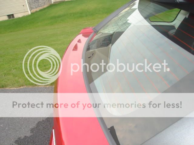

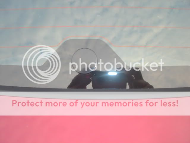

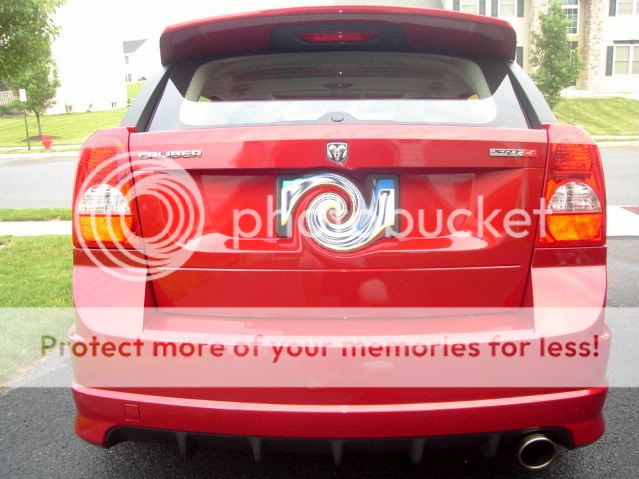

I just finished mine a few days ago
it only takes a few minutes to remove the plastic from under the deck lid to access the wiper motor
I removed all things related to the rear wiper
it didn't shave much weight ( not the reason for doing this) but all parts combined was almost 3lbs
I don't like rear wipers which is why I removed it / looks much cleaner now
used a 1 1/8" metal cap from Lowe's to cover the hole
sanded, primed, and coated in semi-gloss black
then pressed in with a very light coating of clear silicone around the mating surface
if you guys want pics...I'll post them up
here you go...

as a side note
guys do this all the time on their MS3's and other various cars
the standard hole size (when it's through rear glass) is 1 1/8"
there are many ways to plug the hole (mits will love that comment)
other than the metal plug I used
you can even buy rubber plugs on fleabay listed as rear wiper delete
get ready to pay $15 bucks for a 99 cent plug though

pics in 1st post

maybe its a mazda thing? Your the 1st person I've ever seen with this done......I know I would rather put a rear wiper on a car that didnt have 1, rather than taking 1 off. Your uninstall looks really clean, props on that.
