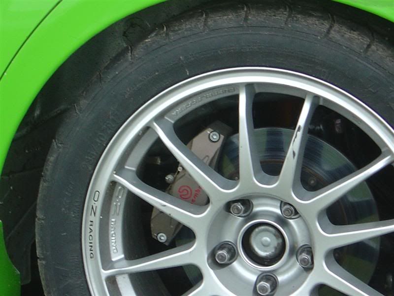

Brembo stamps their rotars, i don't see a logo anywhere to confirm that those came from (1) an STI and are (2) made by brembro
That design is also not consistant with other brembro braking products, see below for the design:
There are LOTS of ebay crap knock offs which i have no doubt would perform like that picture lol

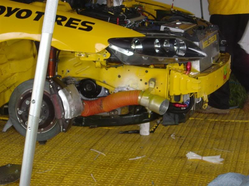

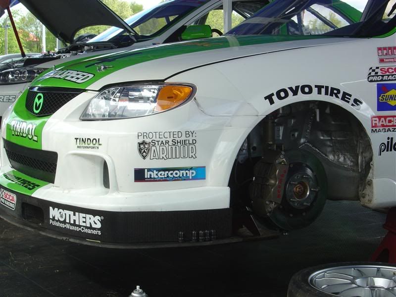

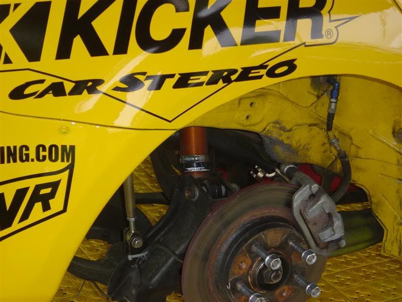

Did you ever stop to think that the cross drilling wasn't for a coolant benefit, but for reduced reciprocating mass?
If you're cooking rotors like that maybe you should look into ducting your brakes and reducing the temperature of the rotor.
I run brembo blanks on the STi, SRT-4, and the neon. :p so im not advocating the use of drilled rotors...just showing their "other" purpose in life.
